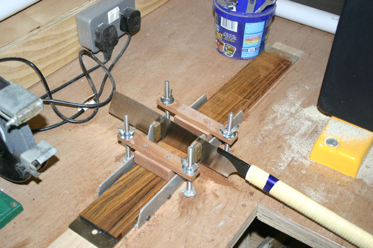

Hi Mattia
I don't know if this is any good to you, but I devised a little clamping system for my Stewmac box as I noticed there was a tiny bit of side to side movement when slotting.
Here is a pic.
The little wooden blocks that go into the box have cork stuck to them, I did think I should add a Cam arangement to them to make it quicker, but I haven't quite got round to it yet, and it is pretty quick anyway.
PostPosted: Sun Feb 05, 2006 5:39 am
